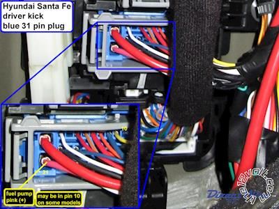

Info from DirecTech wire listing
Santa Fe North America:
Rear Defroster GREEN/ orange (rear defroster); blue/orange or blue (front deicer) - latched dash fuse box, blue 31 pin plug (A), pins 14, 12
Santa Fe, (Smart Key) North America:
No Wire listing for Santa Fe Sport Smart Key.
Maybe this plug
