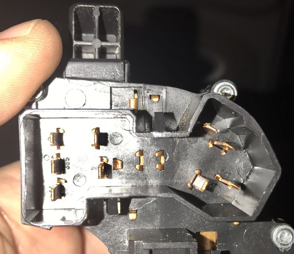

I am searching for the wire color diagram for the turn signal multi switch.
1999 Ford Explorer Sport
The wires were loose and fell out. Some may have been put back in the incorrect positions. Mainly the top portion pins 1-8.
I got a replacement harness from the junkyard and the wires don't match. The discrepancy may be my own fault but I'm unsure.

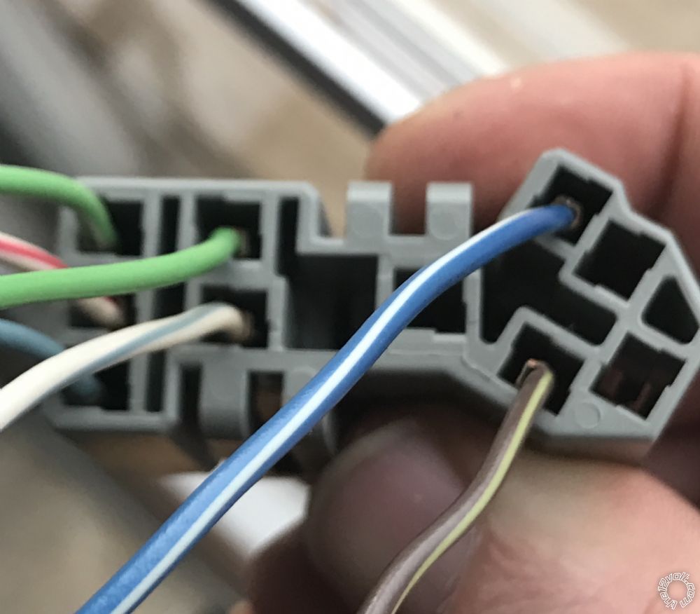

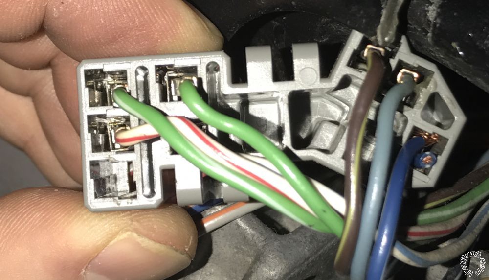

Picture C is on the vehicle
Picture D is the junkyard replacement.
As you can see the discrepancy on terminal 5 and the reverse of wires 6 & 8 color . The missing wire from between pin 7 & 8.
So I'm in trouble and in need of help as I'm stuck without a vehicle.
PLEASE HELP. Thank you

Terminal 4 & 7 (not 5)
