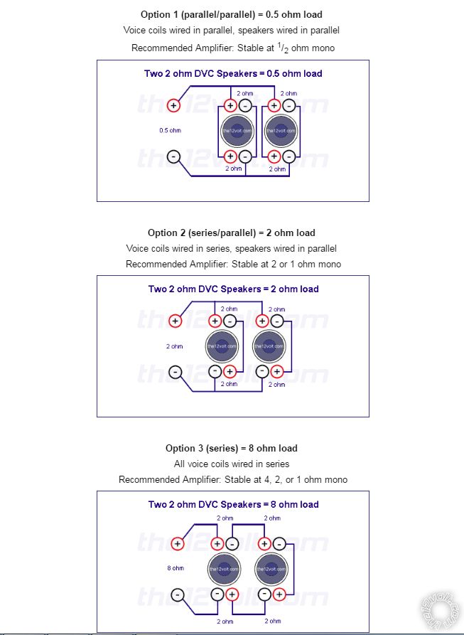

If you intend on using two dual 2 subs, then you'll be fine because you can run a 2 dual two subs at 2 ohm stable.

thanks Mtxtech and DYohn,
I'll go for the option 2, series/parallel to meet 2ohm load.
