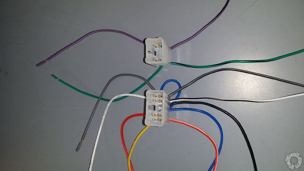

I am in need of a wiring diagram for the stock stereo of a 2016 subaru wrx. The stock stereo uses a 10 and 6 pin harness. Preferably with the color coding and wire to pin location.

2016 Subaru Stereo Wiring -- posted image.
This is the harness that would plug into the factory harness if you were changing the radio to an aftermarket deck.   If you are changing the deck out, please go to your local stereo shop and purchase a metra 70-1761

I plan on keeping the factory deck for at least a little while. i am putting in a 4 channel amp for the speakers and replacing the speakers as well. but without knowing the color coding of which wire is which coming out of the back of the factory deck i can't know which wires to connect for the speakers to connect to the amp.

See my picture. Visualize plugging the radio harness into the plug in my picture. White is left front. Grey is right front. Green is left rear. Purple is right rear. I positioned both so you can see the black stripe on each pair. Black stripe is the negative wire.
