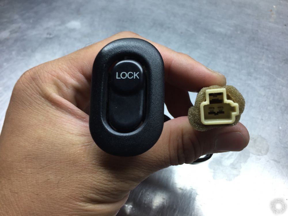

Hey guys I'm a little stumped. The OEM door lock switch is has two wires coming from it and I'm trying to figure out how to wiring it into my aftermarket alarm.
The aftermarket alarm is set up so that it uses a negative pulse on two relays to lock or unlock the doors.
It essentially looks like this
Wiring OEM door lock switch to aftermarket alarm -- posted image.
Ideally I would use a 3 way switch that will provide a negative input that will trigger either of the relays. The only problem is that the OEM switch only has 2 wires coming from it. So how do I get this to work?

In order to use that switch you will have to disassemble it, remove the 2 resistors inside of it, and solder wires to the 3 terminals on the switch. Apply ground to the middle terminal of the switch. The other 2 wires will be lock or unlock.

You're absolutely right! I totally forgot to include the make and model of the car. It's a 2000 Mazda Miata and I took the time to take the switch a part and another board member from the Miata.net forums made a diagram for me to follow.
Here's a video of the results in action!!!
https://www.youtube.com/watch?v=kiyHRMo94VY
When my old alarm went on the fritz I had to unplug the brain and haven't had power door locks in 3 years! Funny how the simplest things are the BEST!

I was not absolutely right. There was only 1 resistor.
