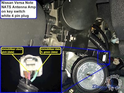

I'm looking for the immobilizer on a 2016 Nissan versa note sv... I am installing a remote start with a T-harness and there is no flat 4 pin white plug on the ignition barrel.
There is a cable running off the side of the ignition but no white clips.

what brand of remote starter and bypass are you using ? see my pic for the immobilizer plug location.16 Nissan versa note sv, immobilizer -- posted image.

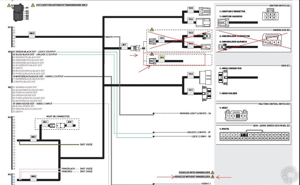

Compustar system with an Idatalink T-harness which plugs directly into the factory plugs.
My car doesn't have that black ring around the ignition, it is just the silver ignition barrel. I was reading somewhere that some 2016 Nissan versa's did not come with an immobilizer. Could that be true?

yes some vehicles in the United States of America do not have an immobilizer as it's not a requirement, in Canada and I think in the UK it is required for all vehicles to have an immobilizer. Most bypasses you can skip the the Immobilizer connection if you don't have it, follow the install diagram I will tell you how to skip the immobilizer connection, I'm assuming you have the new compustar dc3 with the t harness, if so they have instructions how to skip the immobilizer connection in the install diagram.

your welcome here is a picture of the install diagram follow my red edit markings. with the red arrows and boxes. 16 Nissan versa note sv, immobilizer -- posted image.
