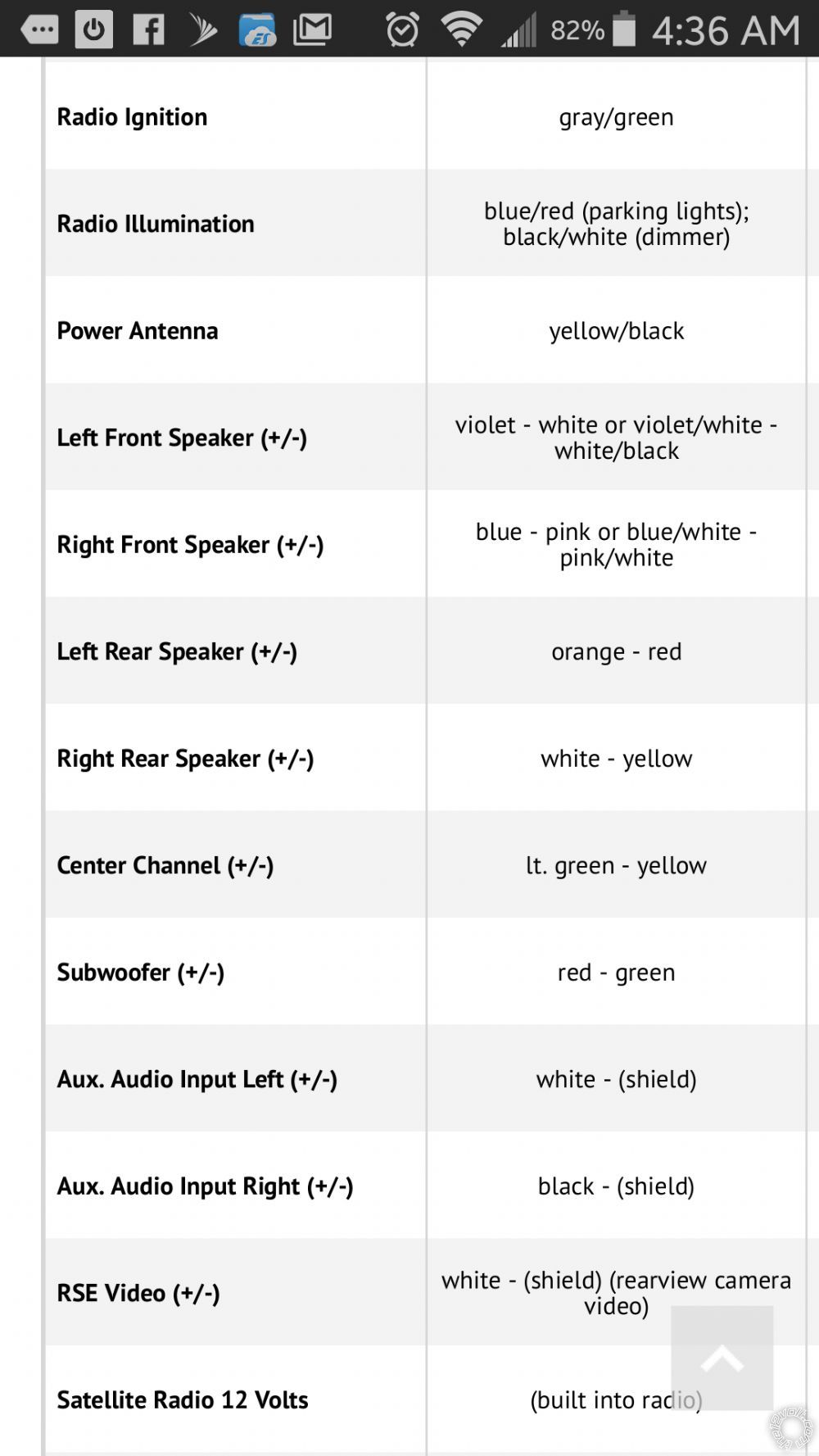

I am looking for wire color's to for a 2016 Legacy stock stereo. I am looking to add in an amp and Sub's to my car and need to know what to hook into for a remote wire, and if there's a stock sub signal or if I need to pull it off the rear door speakers.

If it has a subwoofer you must get signal there. The amplifier is located under 1 of the front seats.
The power antenna wire may only have voltage when the tuner is selected as a source. If that is the case you may have to use ignition to turn on your amplifier.
2016 Subaru Legacy Stereo Wiring -- posted image.

Thank you! My car does not have the sub out at all. There is no speaker. The Remote wire did have a constant 12v when the radio was turned on it is a gray/green. All speaker connections are correct. Thank you
