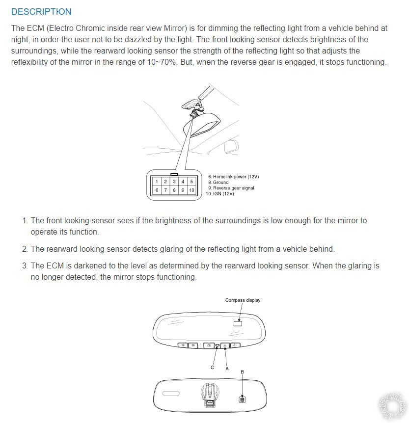

tdi200
Member - Posts: 46
Joined: July 12, 2014
Posted: March 07, 2018 at 11:23 AM / IP Logged
found this from hyundai forum so you were right the other wire was indeed for undim the mirror based on the diagram i will be wanting my homelink only work on when keys are in so i will be using pin 10 and pin 8 for ground 2007 Hyundai Azera Rear View Mirror Pinouts -- posted image.
