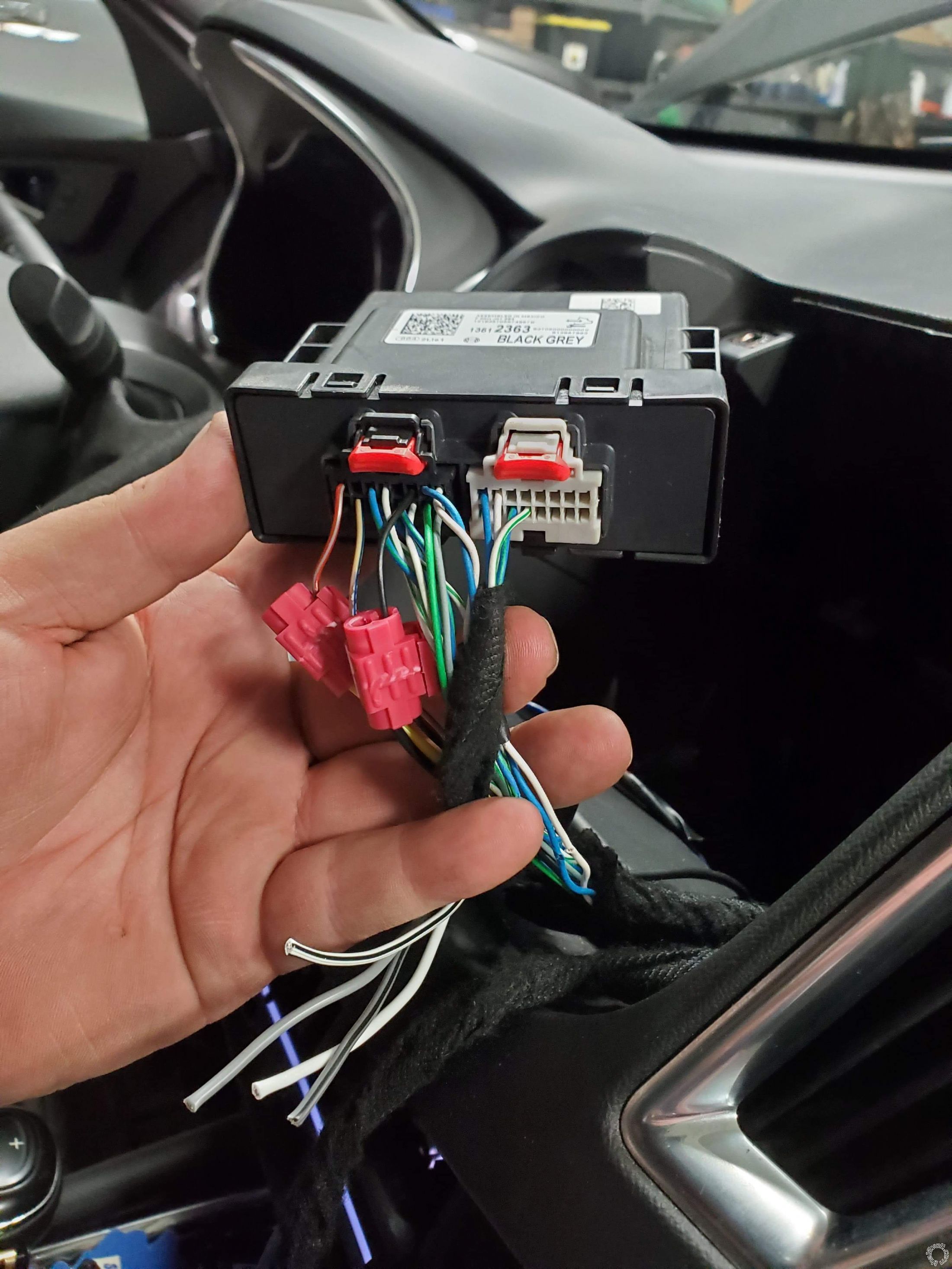

Hello - I must be missing something here. I am trying to do the same thing but my colors do not match what is listed here.
Here is a pic of my wiring harness. Can anyone clarify for me? Am I looking at the wrong harness? This one connects to the dash stereo/head unit. 2017 Chevrolet Malibu Stereo Wiring Colors -- posted image.
Platinum - Posts: 13,723
Posted: November 11, 2019 at 7:33 PM / IP Logged Link to Post Post Reply Quote i am an idiot
That is not your amplifier. Amplifier is in the trunk on the passenger side. Up against the back of the seat.
cwalt
Joined: November 11, 2019
Posted: November 11, 2019 at 7:40 PM / IP Logged Link to Post Post Reply Quote cwalt
Is there a separate amplifier even if it is the basic stereo model? I guess it would make sense that yes there is since nothing is large enough to have an amp on the inside (stereo and the harness that I show in the pic).
Thank you so very very much for the clarification!
**Edit**
That was it, thank you again!!
