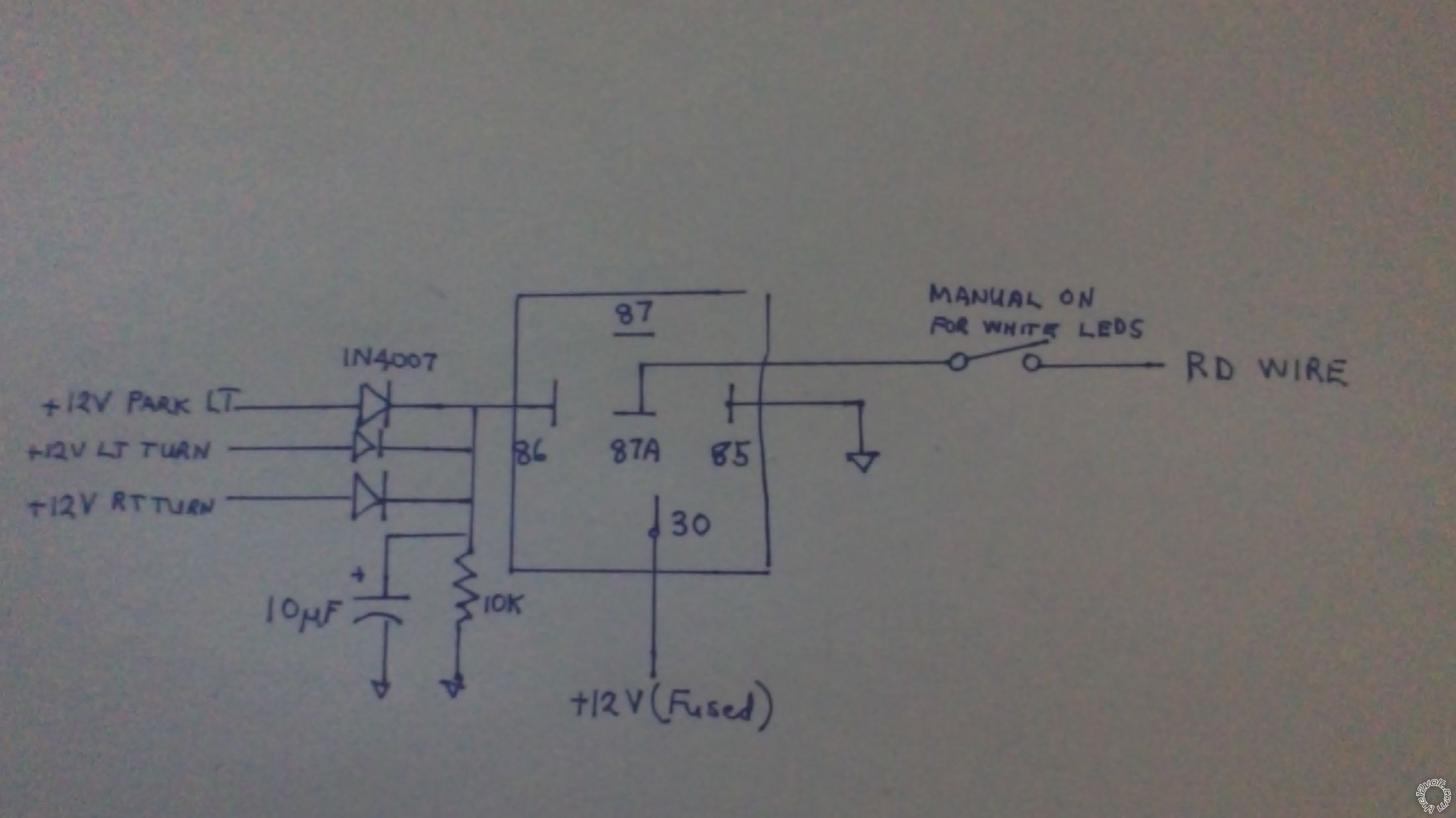

Get a trailer light converter to handle the amber light.
Connect the device's Stop light input wire to your vehicle's parking lights.
Make sure you don't exceed the current capacity of the device's stop/turn circuitry.
How were you planning to disable the white light when parking/turn are activated?

Posted: August 31, 2018 at 8:25 AM / IP Logged Link to Post Post Reply Quote eguru
Try this circuit to disable the white LEDs when either turn signal or the parking lights are activated.LED Fog Light and Turn Signal, '94 Toyota 4Runner -- posted image.

Posted: August 31, 2018 at 2:31 PM / IP Logged Link to Post Post Reply Quote 4runninin
I will give that a try. Thanks for the suggestion.
