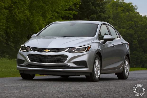

Posted: September 13, 2018 at 4:19 PM / IP Logged Link to Post Post Reply Quote sharkland
This is what my car looks like. 2016 Chevy Cruze Limited Sedan Stereo Wiring Diagram -- posted image.

Posted: September 13, 2018 at 8:03 PM / IP Logged Link to Post Post Reply Quote i am an idiot
Smart Key?

sharkland
Joined: September 13, 2018
Posted: September 14, 2018 at 8:28 AM / IP Logged Link to Post Post Reply Quote sharkland
No smart key. Where did you find this information?
