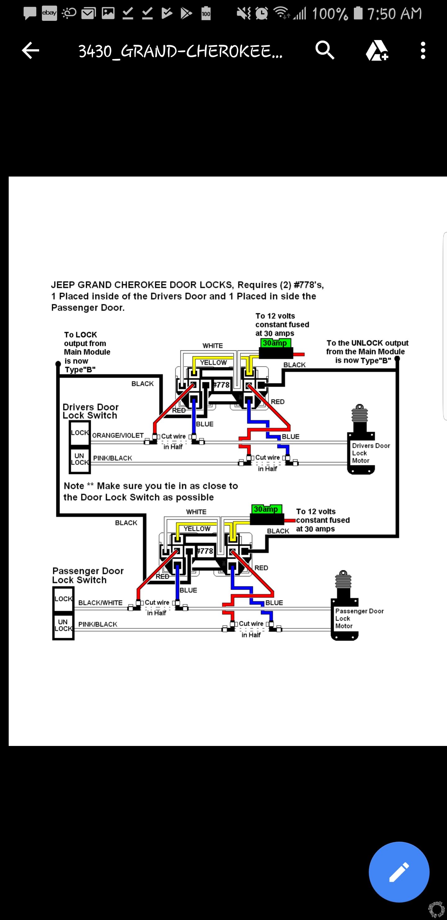

Not using a data module to control the door locks in that vehicle is a labor intensive and time consuming task.
Basically you will need 4 relays and have to go into both front doors to complete the install. If you want to
go that way, here is a link to some helpful information from Bulldog Security :
    http://diagrams.marktoonen.nl/DOWNLOADS/3430_GRAND-CHEROKEE_JEEP%20GRAND%20CHEROKEE%20LOCKS.pdf
They show it with their prewired "778 relays" but you can duplicate it with regular 30/40 Amp SPDT relays.

If I only put 1 relay in each front door, won't it only control the 2 front doors?

Also, I already have all the relaus. Once I get the door panel off, there are the 2 wires running from inside the boot up to the switch and those are the only wires I see. Where do I splice them?
Platinum - Posts: 13,726
Posted: November 11, 2018 at 7:09 AM / IP Logged Link to Post Post Reply Quote i am an idiot
You can actually get to the 3 connections of either of the door lock switches. You can then use only 2 relays in only one door. This will unlock and lock all 5 doors. It has been a while since we have done 1. If you remove the housing from the door and take some pictures I can guide you. This duplicates the switch being pressed.
Relays as such. 30 of both relays to the common connection of the switch. 87 of 1 to the lock of switch. 87 of the other relay to unlock.
This does require soldering onto a circuit board. And following traces from switch to the next down line connection to solder to.

If I can avoid soldering, I want to do that at all costs. Even if it's following the instructions by kreg. After I destroyed my gauge cluster on my other vehicle while trying to changed light color, I'll never get a soldering iron close to a vehicle again lmao.
So basically I need 4 relays, 2 for each front door...

Posted: November 11, 2018 at 7:20 AM / IP Logged Link to Post Post Reply Quote squallz
Lock Problem in 2004 Grand Cherokee -- posted image.
Here..4 relays 2 for each door (even though it only says 2, but shows 4).
Will this work if my RS/KLE module outputs a negative pulse for door locks? Is that what this diagram is for?
