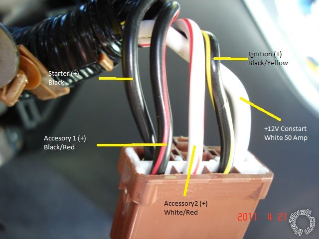

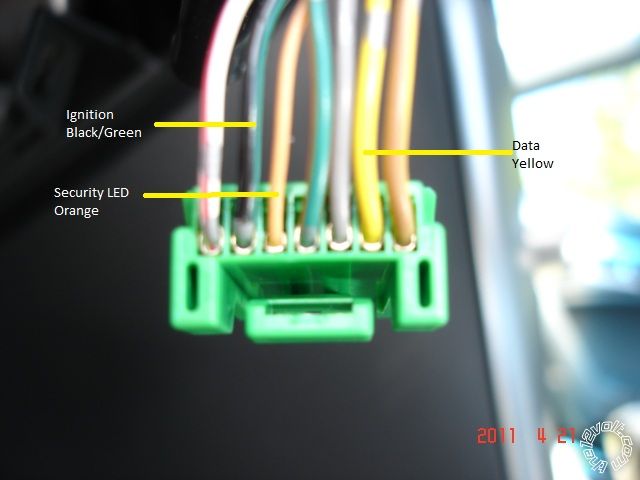

Here are some photos for the wiring :
Blade AL, 2008 Acura TL -- posted image.

Yes I reset it multiple times already. I have not flashed firmware yet. Just got it yesterday in mail so just going off from what I have. Where would I wire the ignition black/green wire to? Blade wiring only shoes to wire 4 wires. 2 wire to security, 1 wire to data and the other to door data.
Platinum - Posts: 7,827
Posted: December 16, 2018 at 4:59 PM / IP Logged Link to Post Post Reply Quote kreg357
That photo is from an install using an older version of ADS firmware. Your newer firmware no longer uses that wire. Just follow the current wiring diagram.
The Blade AL cartridge does not come from the factory with your particular HA1 firmware. You will need to use the ADS USB cable to flash it with the HA1 firmware. Everything will go smoothly after that.
