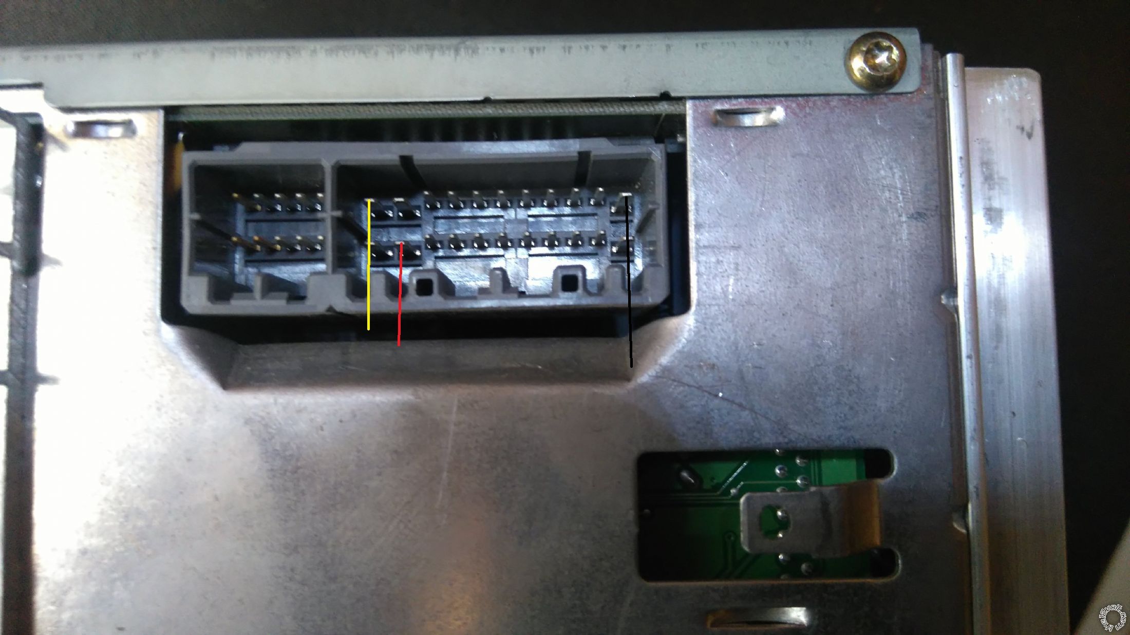

Thanks for the fast response, I just repaired this unit for a friend (had a stuck cassette in it and needed a switch replaced) and want to bench test it and need to know where the power connection goes.
Platinum - Posts: 13,725
Posted: February 14, 2019 at 2:32 PM / IP Logged Link to Post Post Reply Quote i am an idiot
Post a picture of the back of the radio so we can see which harness it uses.
axel13
Joined: February 13, 2019
Posted: February 14, 2019 at 2:57 PM / IP Logged Link to Post Post Reply Quote axel13
here is a pic of the connection on the back of the unit 02-04 Daimler Chrysler Car Stereo Wiring Harness Diagram -- posted image.
Posted: February 14, 2019 at 7:50 PM / IP Logged Link to Post Post Reply Quote i am an idiot
Yellow line goes through the 2 terminals for constant power.
Red line ends at switched power.
Black line goes through both of the ground terminals.
Some of these radios are turned on and off via data. You may have to plug it back into the vehicle to test it.
Posted: February 14, 2019 at 7:52 PM / IP Logged Link to Post Post Reply Quote i am an idiot
http://www.metraonline.com/part/71-6502
This is how I came up with the above info.
axel13
Posted: February 14, 2019 at 10:12 PM / IP Logged Link to Post Post Reply Quote axel13
Thank you so much and you're right I will probably have to put it back in again, and again I really appreciate your fast response on this. have a good one!
