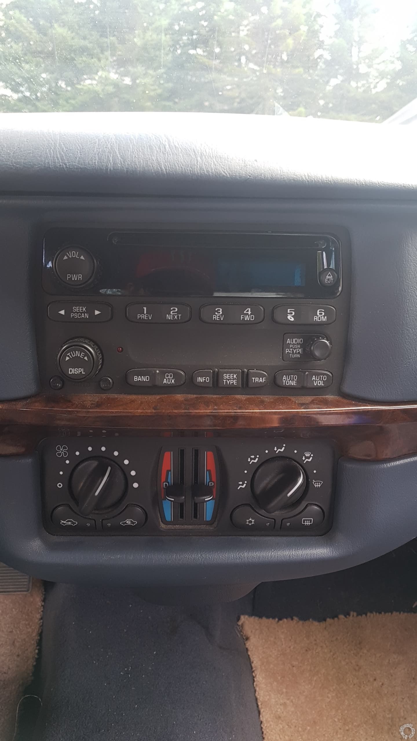

My son has a 2004 Chevy Impala and i want to put in a stereo for him but i can't seem t find the right wiring kit. All i am finding is ones that keep chime and steering controls and such. I do know he does not have onstar, no steering wheel controls and no amplifiers. Just a basic stereo which i added to post.
What wiring kit do i need to get to install a basic aftermarket head unit.
thanks!
Which Wiring Kit for Head Unit, 2004 Chevrolet Impala -- posted image.
Platinum - Posts: 13,726
Posted: September 15, 2019 at 2:55 PM / IP Logged Link to Post Post Reply Quote i am an idiot
Metra 70-2003 will work for you. You will have to find a switched power source to make it go on and off with the key. There is a suitable wire at rear of the air conditioner controls. Brown wire on the plug with the larger wires.
