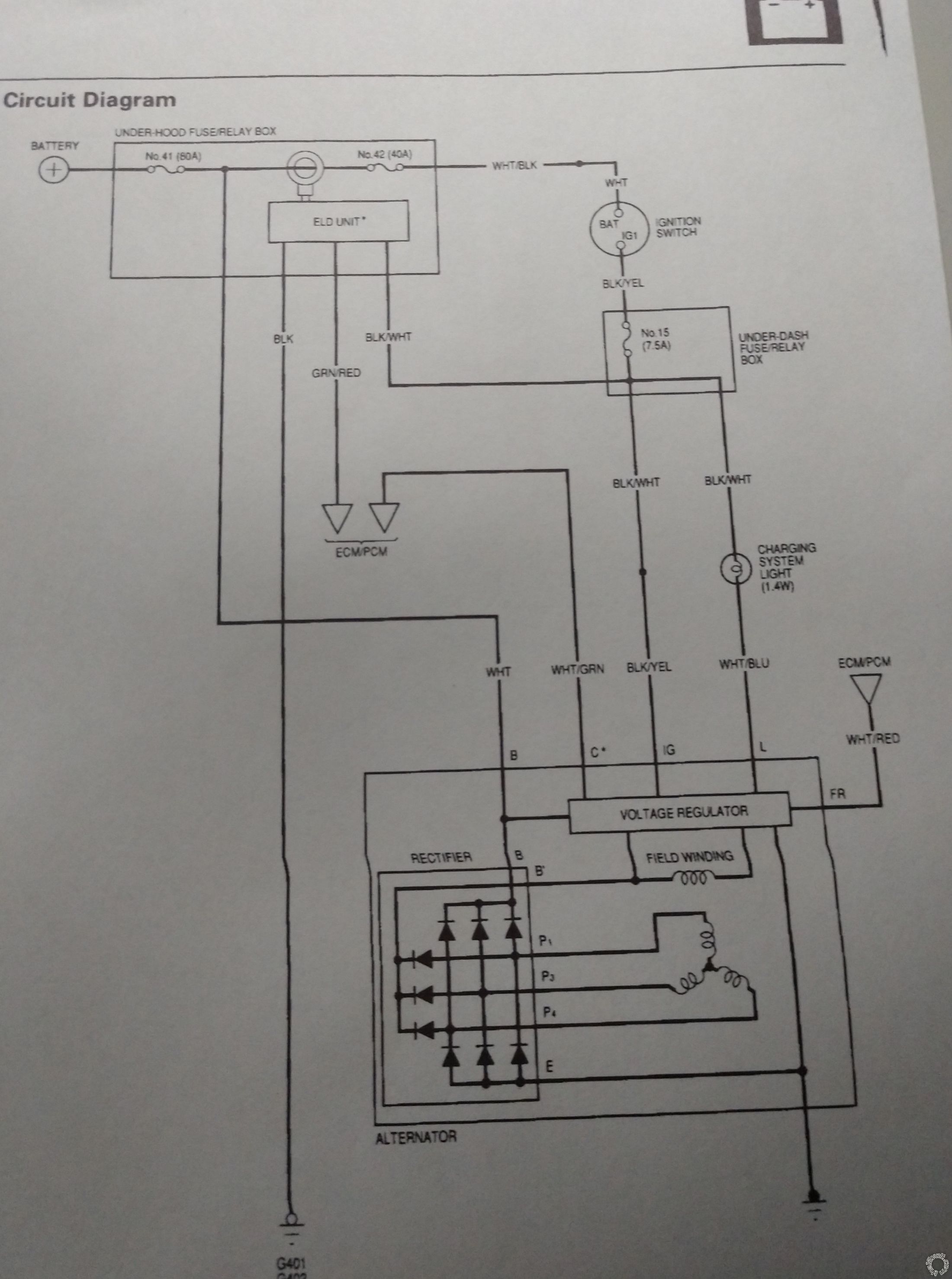

Having no luck trying to increase my voltage by wiring in a diode. My educated guess...... Has failed. I'm going to be running a lithium battery made out of cmax cells. I'm charging around 14 volts but need to get to at least 15 volts I've wired up diodes before in the sense wire to bump up the voltage but the Civic alternator doesn't have a "sense wire" if anyone has any experience or information in regards to this issue it'd be greatly appreciated im at a dead end

Wiring diagram .....I attempted the diode on the c wire
