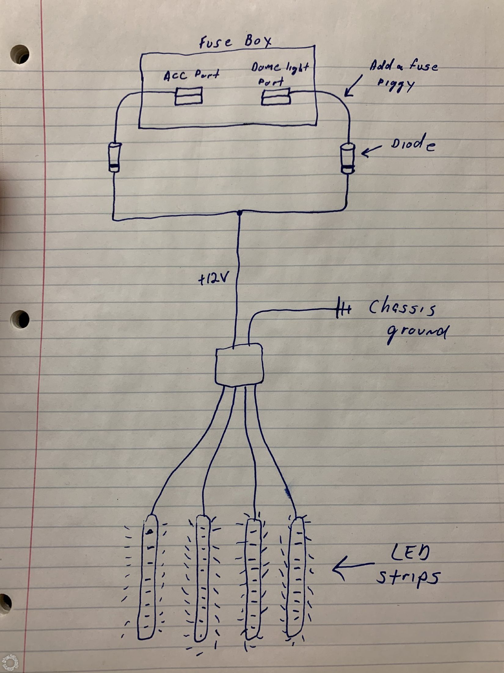

Yes, that is feasible.
Alternately, skip the relay and just use two diodes with appropriate current ratings.
I suspect your LED strip lights would draw less than 2A.

Posted: April 30, 2020 at 9:56 AM / IP Logged Link to Post Post Reply Quote dieselmike
Thanks. Is this what you are proposing?
Turn On LED Interior Strip Lights From 2 Triggers -- posted image.

Posted: April 30, 2020 at 3:22 PM / IP Logged Link to Post Post Reply Quote eguru
Yes that is it exactly.
