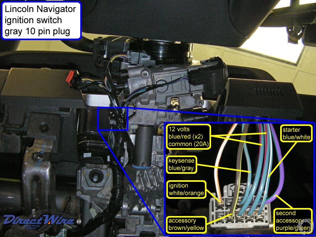

Posted: September 26, 2021 at 8:01 PM / IP Logged Link to Post Post Reply Quote i am an idiot
Switched power source = something that turns off when the key is turned off.
Use a volt meter to verify, I do not think either of the Accessory wires will work. You may have to use the White/Orange ignition wire. Put a 1 amp fuse where you tap into this wire. Run it to the red wire of the new radio. Disconnect it from the cigarette lighter wire that you have it connected to.
2010 Ford Expedition, New Radio Does Not Power Up -- posted image.
Platinum - Posts: 13,722
Posted: September 26, 2021 at 8:02 PM / IP Logged Link to Post Post Reply Quote i am an idiot
Above picture is of the underside of your steering column. You will have to remove the knee bolster.
