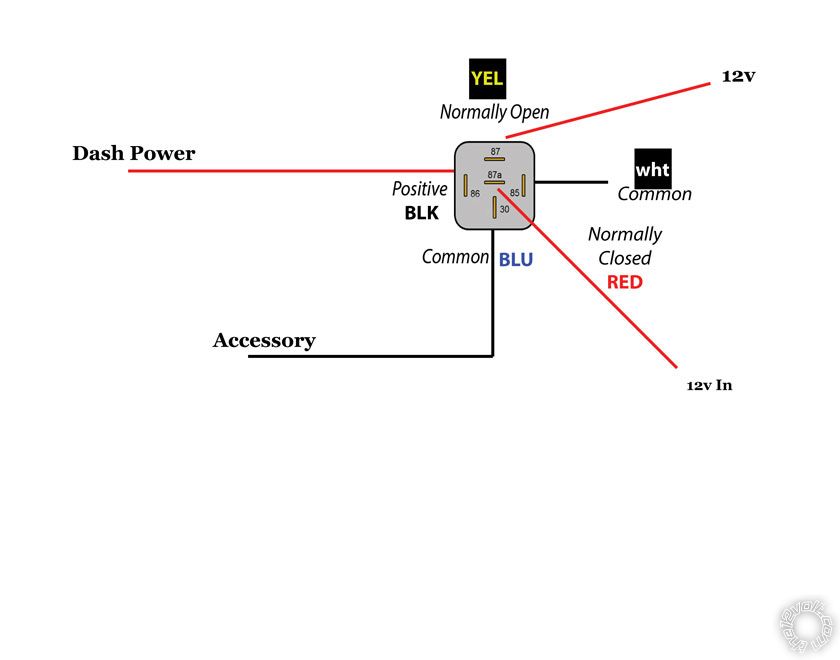

Can I use a 12v relay to transfer from the car battery to the house battery.
I want to set it up so the relay transfers power for certain accessories to an accessory battery. Then when the car turns back on the power is transferred back to the car battery.
Can I Use An SPDT 5 Wire Relay As A Transfer Switch? -- posted image.

I think that would work just fine
