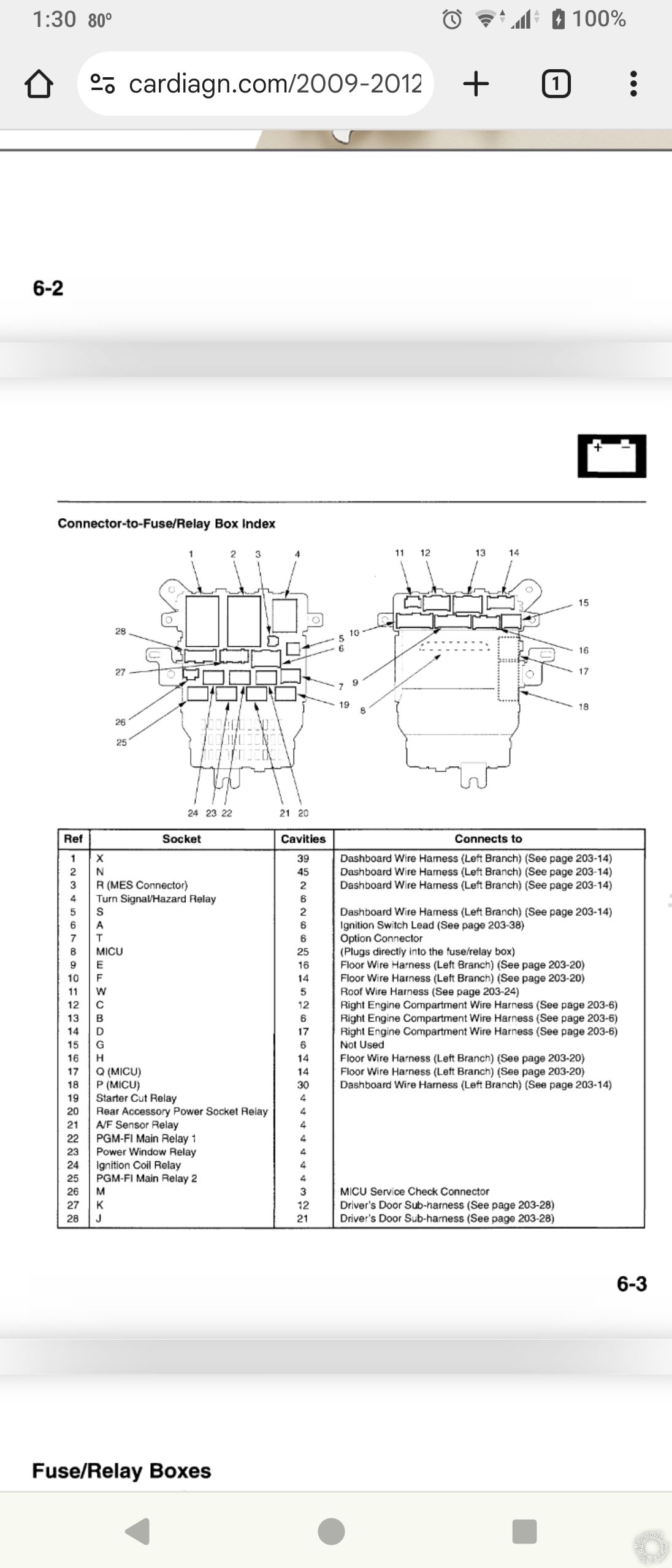

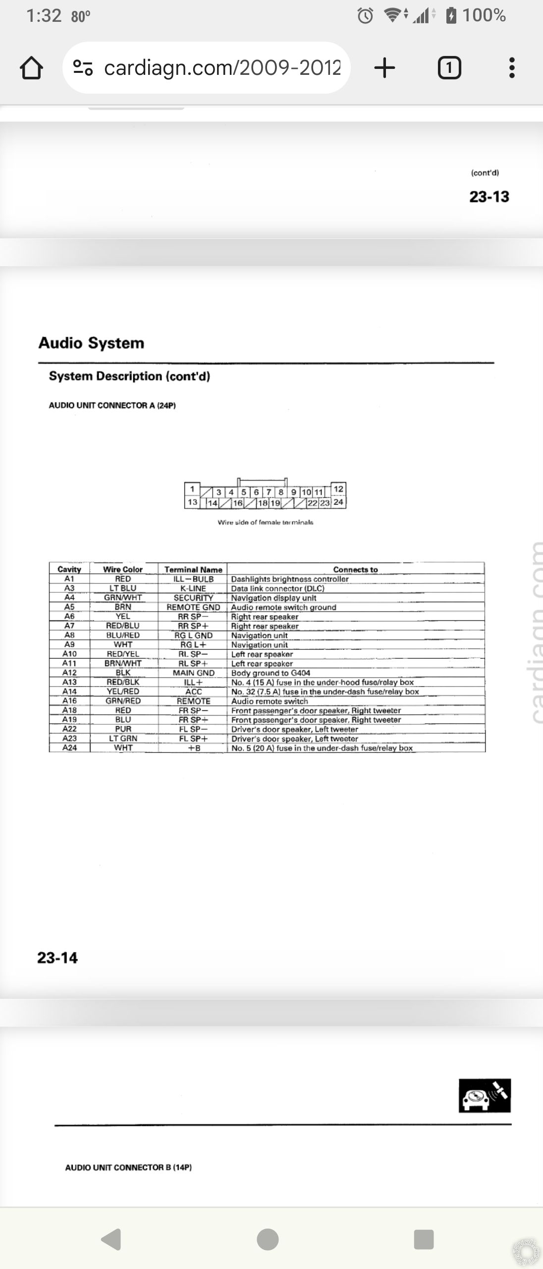

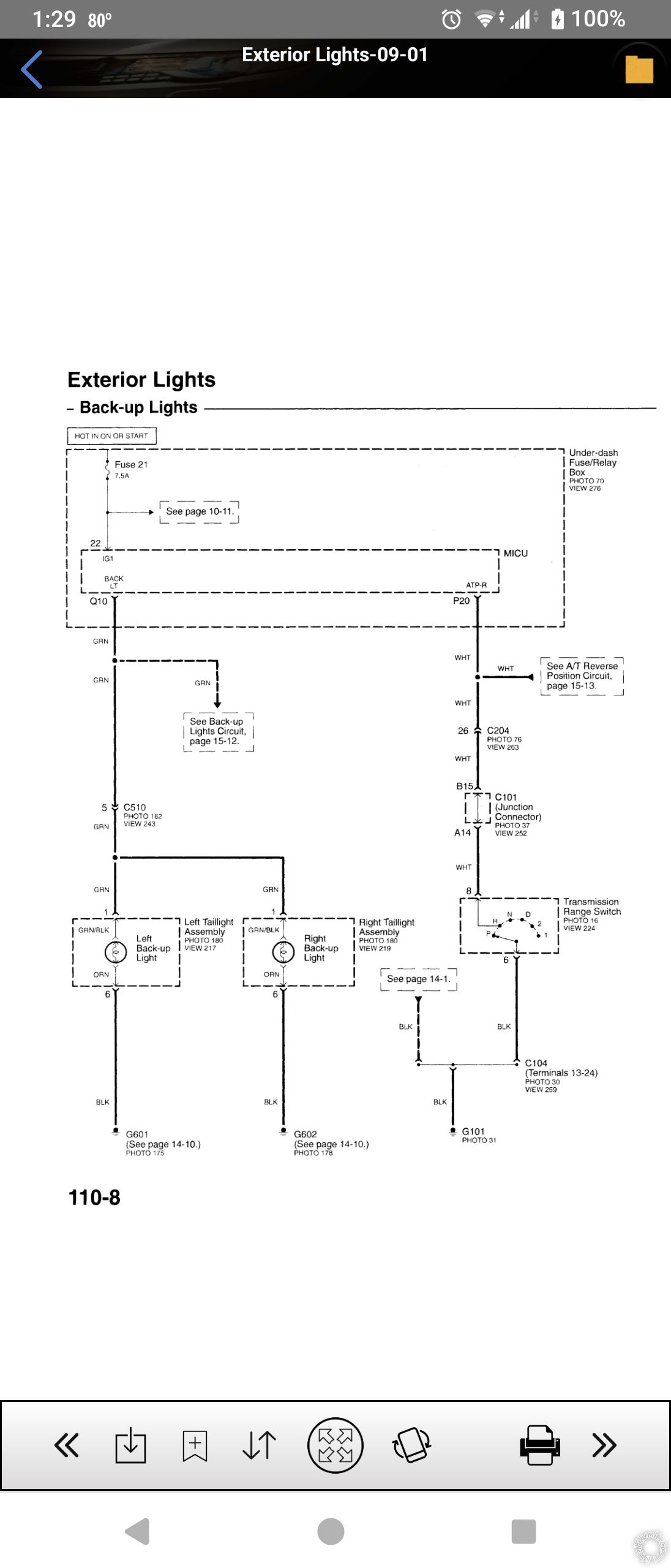

If you're using an adapter harness, illumination will be the orange wire and test positive 12 volts with the parking lights. This wire is listed in the factory harness as the red/black wire in A13. The dimmer wire is listed as red in A1.
Reverse is listed as a green wire at the interior fuse box Q10 (14 pin connector Q, pin 10) 2011 Honda Ridgeline RTL, Stereo And Backup Camera Wiring -- posted image. 2011 Honda Ridgeline RTL, Stereo And Backup Camera Wiring -- posted image. 2011 Honda Ridgeline RTL, Stereo And Backup Camera Wiring -- posted image.
