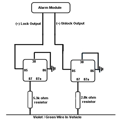

I always recommend the diagram below for resistor door locks for a few reasons:
1. Using the positive locks from the module saves the need to put an fuse inline. 99% of units out there will have flip flopping +/- locks.
2. Aside from the lock wires themselves being positive, there is no 12volts being connected to the relays meaning very little chance of you wiring them wrong and throwing 12volts into the negative lock wire..
Either diagram works. Good luck,
Mike
