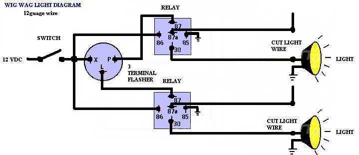

I think what you really want to do is isolate them using diode's. The wire you attatched to on the brake light! You need to put a diode in place on the wire from the car going to the brake light.
If you wanted to save yourself some money search this site for "wig wag" as the topic and me as the author. I have posted a diagram near the end of that post that would do that same for you.
To my knowledge the12volt never put the diagram in the data base for others to see.
Alternating Flasher unit -- posted image.
