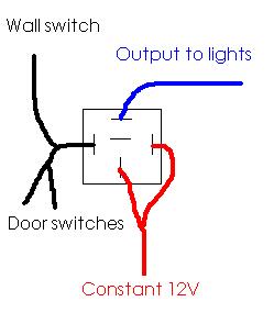

The wall switch now overrides the door switches, that's the way it should be. My problem is that each door trigger which is grounded when closed and +12vdc when opened, works fine by itself. I can't seem to add the second trigger....seems that when both doors are connected, if only one door is opened the other door grounds that +12vdc and prevents the relay from operating. Am I explaining that correctly? This is a remounted ambulance that never came with a wiring diagram so I'm mostly in the dark (literally hahaha). Thanks for any help!

Well what I would do is wire the ground to constantly be at the lights and also wire the door switches/wall switch to pass a ground. Then wire a relay like the one below. If you want the wall switch to override the system then another relay would be required. Relay is a SPDT. I know this would require rewiring most of the existing system. This would take care of the issue you have with the doors doint wierd things with preventing the lights from working.
interior lights w/magnetic switches -- posted image.
