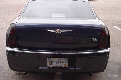

I tint taillights all the time at my shop. I remove the taillights first from the vehicle. Then I use 180 grit on a da sander and remove all the writing on the taillights. This is usually the dot numbers and part numbers. Then i use 600 grit on a da and smooth the taillights out to my liking. Then I prep the taillights with wax and grease remover to remove any oils on them. This is the hardest part which is to take your normal automotive clear coat and put some black base coat into the clear coat. Dont worry even though it looks dark when you add the black base coat it will actually go on light and take several coats. I usually do 4 to 5 coats on each set of taillights. I use a mixture ratio of 5:1 which is 5 parts clear coat to one part black base coat. After you have applied the clearcoat to your darkness let dry for at least 12 hours. Next if you have any imperfections in your clear coat just wet sand and buff. Now your done and enjoy your new tinted taillights.
Here is a pictinted tail lights -- posted image.
