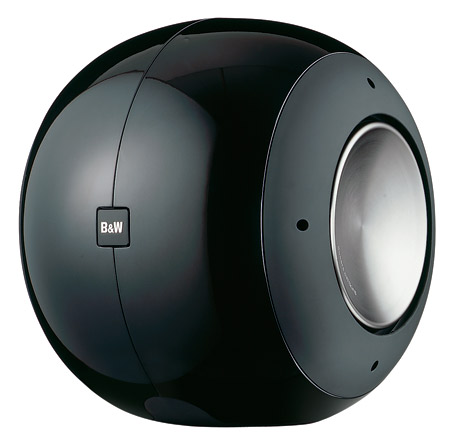

i cant seem to upload a good picture of the bang and olufsen sub but heres something similar to the idea I have
is this enclosure possible? -- posted image.
and yes, i plan on piano black as well, so thats probably exaclty how i would want it to look. and i planned on running a dayton reference high fidelity 12" with a crown XLS-202.
any suggestions on how i could start this? I was thinking maybe getting a really big styrofoam ball or something and coating that to get an initial shape?
what do you guys think?

I like the B&W much more than the the B&O. If you want to make it off a styrofoam ball, you have to decide if you're going to use a sacrificial mold or if you're going to cast a seperate mold to get this shape.
Yes I do too. Im definitely going to try and mimic the wilkins. And im not sure what you mean by sacrifical mold or separate mold? I figured I could just cast a mold of the ball and then go through the steps of building the enclosure.
But now as i think about ur choice of wording---"sacrificial", i wondered if it would be possible to even just coat the sytrofoam ball itself and carve out a hole for the driver, which could serve as massive insulation! ( or was that what you meant in the first place lol?)

Gee, I remember seeing bubbles being used as skylight, some were acrlyc some fiberglass.  I'm sure if you spent sometime looking for something premoulded, it would be simpler than starting form scratch.  You can alway build box inside or reinforce as needed.

A sacrificial mold is commonly used to make one-off gas tanks. You make your plug out of styrofoam, cover it with a barrier material and then fiberglass on top of that. After the fiberglass has hardened you pour a solvent (such as gasoline) inside of the ball which disolves the styrofoam. This technique is very effective for complex single production products, but is not very enviromentally friendly.
