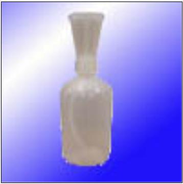

pajokijr, check one of these MEK DISPENSER from Select Products to help you mix the Resin and the Harderner better. beginning a fg project, fleece? - Page 2 -- posted image.
