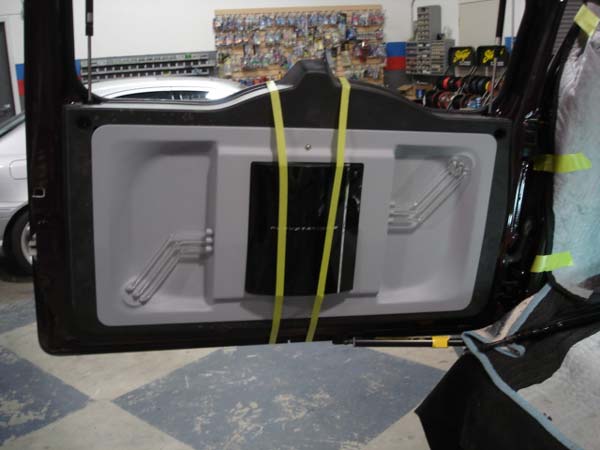

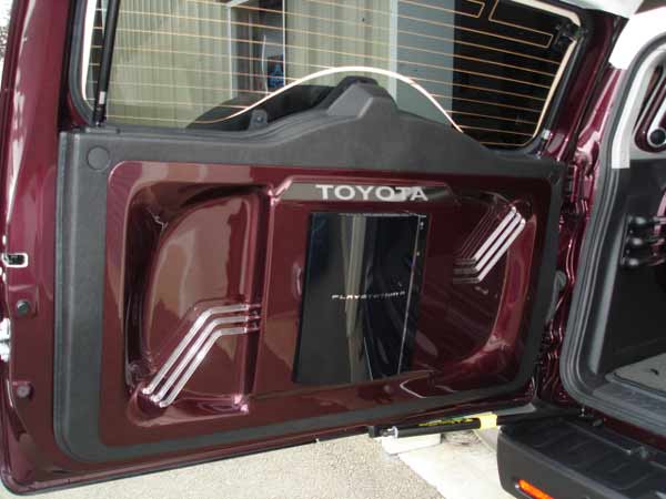

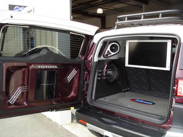

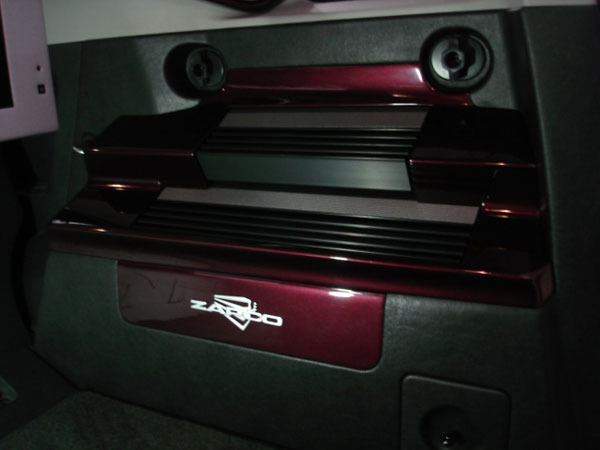

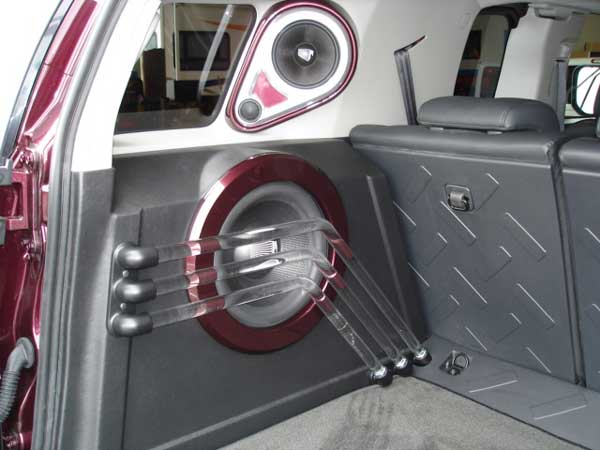

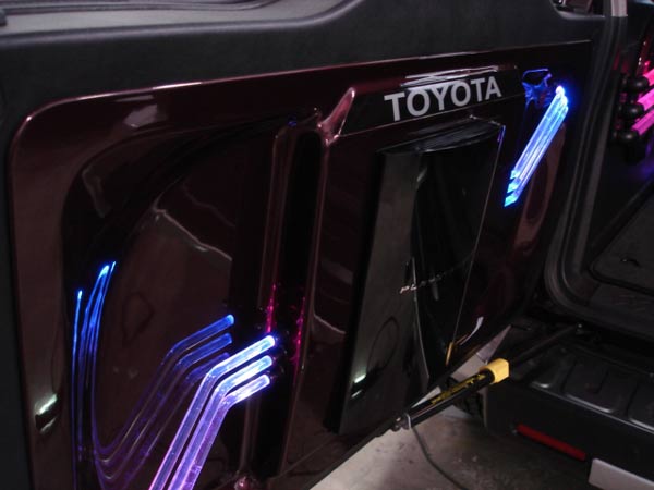

Here are some new pics of a FJ that my Teem and I just completed For Infineon Raceway using “the trick of the year” thinned down body filler to get a perfect paint ready surface. Use this trick (look for the thread “trick of the year”) on every project you want to paint and forget pin holes and multiple layers of body filler.
Codey made The sub box and the speaker pods. My boss Rich of "Enriched" made the TV mount and trim, and I made the PS3 mount.
glass faster -- posted image.
Also when you make your next visit to the auto paint store, ask for high build primer that uses acetone or lacquer thinner for reducer. Buy a cheep $13 paint gun and save even more time! This stuff dries fast! And builds high. Also if you send your stuff out for paint, this primer will not lift.

Nice work Dude. In regards to your " trick of the year " with thinned body filler, I think your a bit behind on this " trick" seeing that it's been used for the past 5 years or longer in our neck of the woods. Regardless, nice design on the FJ Cruiser and good use of the neon lights as grills.

love the neons, did you have to get those custom made or did you just heat em up and bend them?

We heated and bent the plexi rod our selves. Then end lit them with LEDs.

Are those PVC elbows on the end of the Plexi Rods on the grill? How was that accomplished? Quick description would be appreciated. I think it is a great job and clean install. And old tricks like the bondo resin mix is never out of style to mention. Keep up the good work fellas.

Yes those are PVC elbows glued to an ABS plate. Body filler blends the pieces together.
For more info on how this lighting is done check out this thread: https://www.the12volt.com/installbay/forum_posts.asp?tid=91728&PN=1
