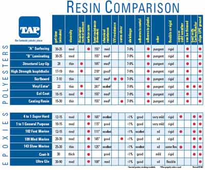

resin downfall? -- posted image.
I pay $65 a gallon for this stuff from www.tapplastics.com. I worked them down to this price. This company has various pricing for various customers. All you have to do is ask. I use an expander called “micro spheres” from the same company. With this expander I can make 1 gallon of epoxy into 5 gallons, and that makes this stuff a bargain! ($49 for a 35lb. bag that will last you years). It should be noted that this expander also works with polyester. The point here though is that the price difference is insignificant.
