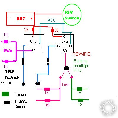

Here is what i want to do I want to run power through a switch on the dash from the battery to the headlights and running lights. I need you guys to PLEASE help me by telling me what color wires in what approximate location of the body of the car I should be able to splice into to get these important systems working. I need a car that can run 24 hours a day not just in daylight hours.

There has to be a way I can put a switch from the battery to a particular wire in the harness that will give me headlights and taillights. I dont at all care about interior lights. As long as I meet legal standards.
Anyone have any ideas here? Im willing to even rewire headlights and tail lights if need be.

But otherwise I'd bypass the lot with all new wiring and relays etc, then control them as desired via diodes or other circuitry (eg, cranking cut-out) - PROVIDED that is legal. (Oh man I love my old cars! I can do almost anything to them.)
Posted By: howie ll
Date Posted: February 14, 2013 at 3:29 AM
All you need is a switch from Mouser or Farnell giving you the following options, off 1 on 1 and 2 on then you do something like this:-
About 8 fuses, 2 relays and 2 diodes.
The switch is wired NEG going to save problems.
Lights side and head only come on with ACC, ign and engine run; will dump on crank.
That should save on legal requirements.
When I can be bothered I'll sketch up an alternative with a buzzer circuit so you can have the side lights on any time.
