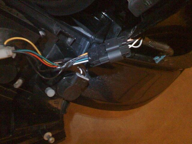

Well, I have a Jeep Grand Cherokee SRT8 that does not come with rear fogs install. I working on a T-Harness to wire the rear fog lights from the tail lights.
when I connect the harness, both the tail light and the rear fog light turn on but both come on like if I was pressing the brakes.
My question is how and where can I still a diode to prevent feed back? If anyone have a diagram it would help me a lot.

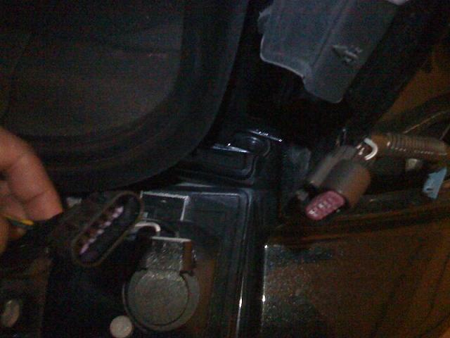

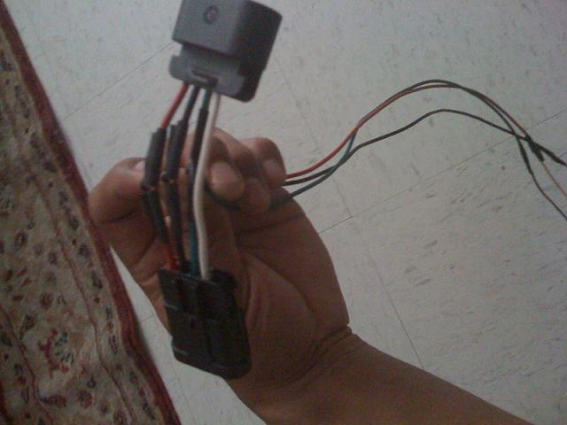

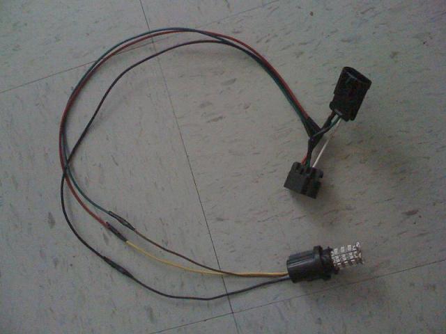

Posted By: lam13
Date Posted: May 03, 2009 at 1:34 PM
posted_image
posted_image
posted_image
posted_image
These are the pictures on how I want to connect the t harness onto the tail lights,
Thanks for any help...

Posted By: i am an idiot
Date Posted: May 03, 2009 at 1:52 PM
That harness is simply paralleling the new socket with the other bulb.  I still have no idea when you want the fog lights to come on.

Posted By: zybeon
Date Posted: August 28, 2009 at 11:56 AM
What you have to do is add diodes to both the turn light wire and the brake light wire. Use a pack of them from radioshack. Make sure the white line is on the side leading to the light.
Posted By: zybeon
Date Posted: August 28, 2009 at 11:59 AM
looked at your pics again, are you sure yo are using a 3157 2 circuit light? those things should be already configured for voltage polarity or you just got a cheap one.
