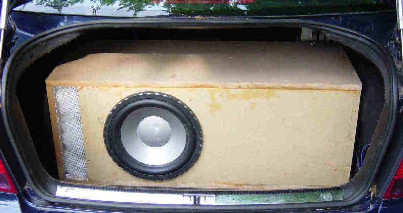

This is my TL right now. If I decide to keep this enclosure I'm going to finish the enclosure so it looks better.
posted_image
posted_image

Nice job.  Now finish that puppy and even if you decide not to keep it, you can probably sell it pretty easily.

But, the title of this thread states the enclosure is finished... I'm confuzzled...
J/K, looks good. I agree to finish it. I know someone here or on ROE will buy it if you don't want it...

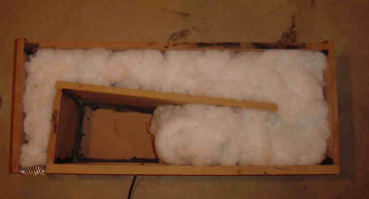

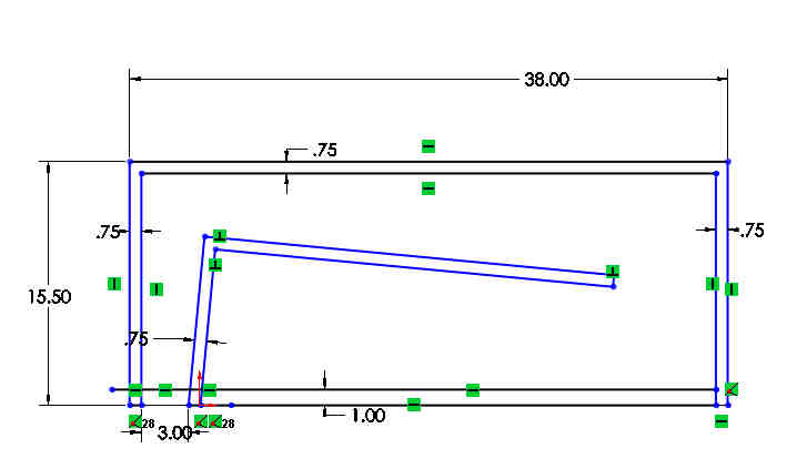

The specs on my TL are:
About 85" length, stuffed dense near the sub and gradually less dense at the end. It starts at about 150% Sd and goes to around 50% or so. I used Acousta-stuff to stuff the line.
posted_image
