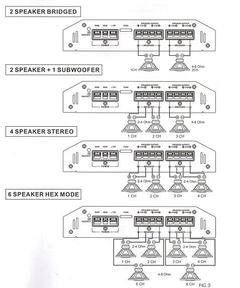

Found this amp boxed away from moving. I cant find any info on it. Anyone familiar with it? AUTOTEK AT-904. Says it runs hex(6-channel) mode.

Haha I remember those amps with the leads sticking out. No, actually this thing is real modern looking. What they call the "HEX" is aka tri-mode. Meaning that the 5th and 6th speakers are simultaneously wired to the the output terminals used to bridge to 2 channel mode. So it runs 2-4 ohm stereo on 4 channels, while(when wired accordingly) can run 2 more speakers bridged 4-8 ohm making THE HEX! I googled the amp and it was as if It was never made.

Dug this up.
posted_image

From a sansa media player, to a Clarion EQ7, to this amp, I can push both 4 ohm coils of a 12" Memphis reference out of this orbit. No heat no question. I normally look to class D for amplifying subs. But this amp rox out.
