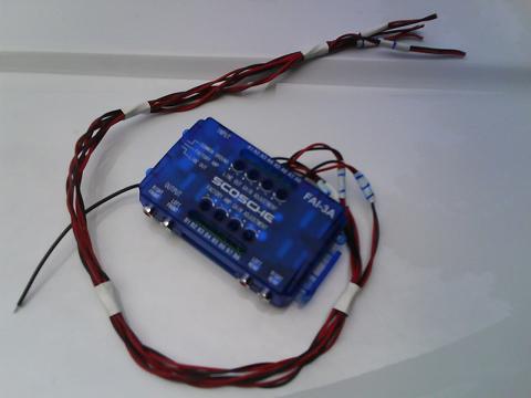

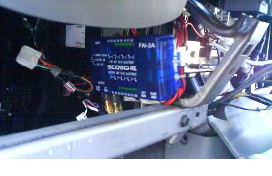

One to grow on.....A adjustable line converter can fit somewhere in most dashes. Attach some short leads to the converter and pickup your signal right off the deck. Leave enough slack on rca so if you ever upgrade source, your already linked to amp. Use converter/gain setting
posted_image
posted_image
