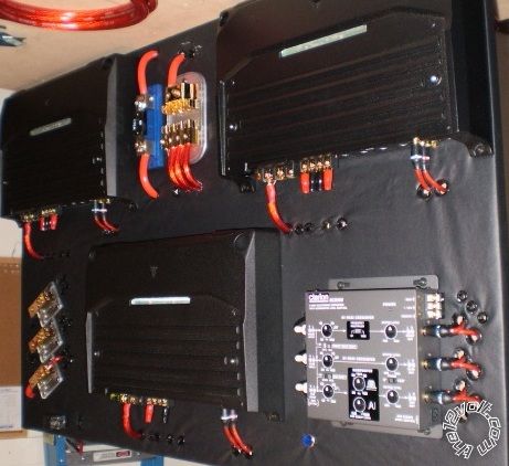

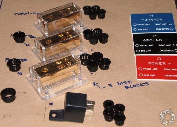

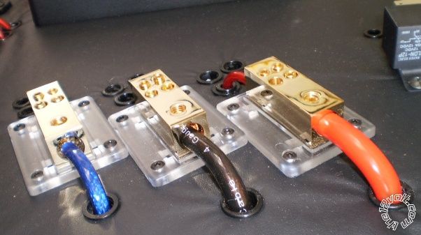

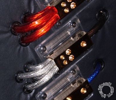

We all do things differently, and I'll admit I tend to do what I have NEVER seen ANYONE do: I tend to use a SEPARATE distribution block for EACH amp. Call me weird (you won't be the first). But I have used a distribution block for POWER, GROUND, and TURN-ON leads. Why? Because I wanted to be different. And because I could run ONE ground wire from ground to block A, ONE power wire from fuse block to block B, and one Turn-On lead from relay to block C. It makes for a neater install and looks cool, but otherwise it even saves on length of each wire to each powered item.
So, since I don't agree with your theory on relays, I figured I would give you something to laugh about or not agree with about me.
