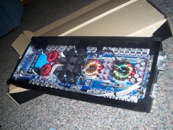

I have the SAZ-3000d it does 3k at one ohm. I have 3 RE sx 10's wired around .5 ohms they are in a 5cu^3 box tuned to 38hz I hit a 149.2 in a ext cab s10.
Here is a pic
posted_image
