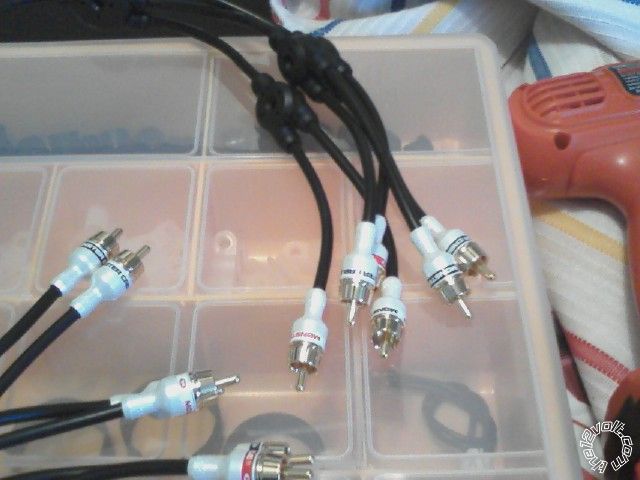

Oh, forgot to mention HOW it is I grounded my RCA jacks from the head unit ouputs: I ran a ground wire to the metal dash support bracket and connected 2 cables to a Y pigtail. To test this method, I had the engine running and the loud whine was there. I grounded the one end to the car, then touched one outer RCA sleeve and BAM, whine gone! Well, most of it. I then grounded the other one.
NOW my question is this: since this is the first time I've ever had to ground an RCA, I better ask you folks if I would be better off grounding the RCA's to the head unit body OR a separate chassis ground or does it really matter?
If the rain ever stops today so I won't get drenched, I'm going to try grounding the other RCA cables (front AND rear outputs at the equalizer PLUS both sets at the amp inputs).
I already gave up on checking or replacing my RCA cables since they're some of the best I've used in years, and they had NO whine in my last 3 cars. Just apparently need to ground them due to something haunting this Civic. These are the Montster RCA's I'm running from equalizer to amp (2 now, 3rd when I get my sub amp):

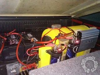

This was a few years back when I first used them for my amp rack for my Dodge Stratus:

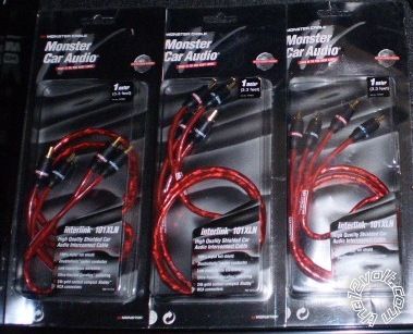

Since I'm running out of options, if moving the amp ground to another location doesn't work, I'll be forced to try different RCA cables. I do have a 6-channel RCA I paid big bucks for that I might try. Or, I have some very expensive home audio/video RCA cables that might work. They have some of the thickest outer cover of any I've seen in years.
Not so sure this RCA is any better than the 101XLN's I'm running now, but I can't afford to rush out and buy anything else right now. But this Monster Cable MicroXLN 6-channel is a start to check to see if the RCA's are the issue.
posted_image
It's what I used in my Dodge Stratus from the head unit outputs to the crossover inputs.

posted_image
