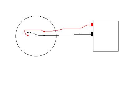

Posted By: Francious70
Date Posted: October 27, 2004 at 1:28 PM
Same sub that I have. Sounds awesome. What are the specks on the amp, because you'll be running it at 2 ohms. But basically you'll wire it like so:
posted_image
Enjoy,
Paul
Date Posted: October 27, 2004 at 1:32 PM
dxav, it's a 4 ohm DVC sub. So either the amp is going to see 2 ohms, or 8 ohms. If that amp is rated @ 350 watts @ 4 ohms then you'll actually be feeding the subs 700 watts. That's a little much. But most mon-block d-calss amps are named for their 2 ohm output.
Paul
Posted By: dxav
Date Posted: October 27, 2004 at 1:35 PM
Ok, Francious70. 2Ohm sounds good. Then, depending on his amp in mono @ 2 Ohms, your sub/amp config should work great on his system.
