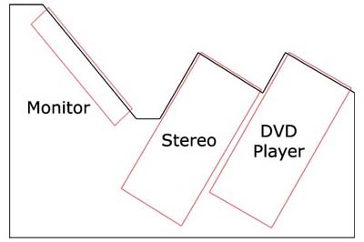

This is a rough side sketch of my center console.
Do you guys think the angles are too steep for the DVD Player and Stereo? Will I have problems with skipping and stuff? I have a limited amount of space and this is the best fit.

Posted By: shrug53
Date Posted: January 15, 2007 at 11:26 AM
I should clarify. The head unit is a Sony Xplod and the DVD player is a Flexvision, if that makes a difference.
They will both be sitting at just about a 45 degree angle.
Posted By: osanboy
Date Posted: January 15, 2007 at 10:48 PM
the whole setup you've got shouldnt affect skipping and other options of the system. but it does seem a little steeper then usual. looks good overall.
Posted By: stevdart
Date Posted: January 16, 2007 at 6:48 AM
A DVD or CD changer should have a 45 degree setting that you can use.  Is your model equipped with the different placement settings?
