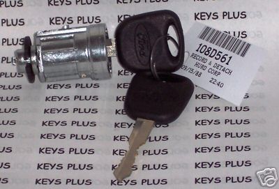

Key looks like this posted_image. I tried the 97 cent walmart key. Opened the door but won't start car.

Those are definitely  transponder keys so you're on the right path.  I don't have a tech sheet on the 1100F, but are you positive it says that it'll work on '98 Contours? I've looked on Bypasskit.com and they have their data interfaces listed for '99-'00, but all they have listed for '98 are RF interfaces(key-in-box type as well as the 555F).
Where do the 2 wires from the transponder ring go to? I'm thinking there may be a decoder module somewhere nearby that would possibly have TX and RX wires for a bypass, but no promises.
