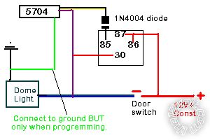

Correct but disconnect the green, use the violet (+) door trigger instead you can still connect yellow black but like this:-C8A_ford.bmp
You will need a relay 4 or 5 pin and a 1N4004 diode for the dome light.
Connect the original green to ground only whilst you program the unit.

Smokeman on the British versions if you're using the violet (+) POS trigger you must ground the green during programming otherwise it won't respond.
OP had the green connected when the dome light is POS switched and then the neg output BLACK / YELLOW supervision wire sans relay also connected.
