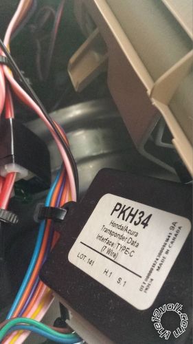

Hi blanx218, Today the weather is good so I went out side and tried reprogramming the bypass module PRK34 but with no success. Two things I need to ask you, are you talking about the LED light on the module which is red OR are you talking about the LED Light of the security system which is placed visibly beside the steering wheel.
Secondly, When you talk about the ignition, do you mean the first click of the ignition where my cd player turns ON and on the second click all the instrument panel lights turn ON and then when I press it further it starts.
Please help me out here as I want to finish it today.
Greatly appreciated.
Thanks.
MAQ
Posted By: harryharris
Date Posted: March 08, 2014 at 12:05 PM
The LED on the module and the second IGN click or position of the key.
Test before boxing up.
Posted By: pichoni123
Date Posted: March 08, 2014 at 8:26 PM
Hi blanx218,
The LED on the bypass module PRK34 does not turn ON even if the ignition switch is OFF or ON or in any state AND there is a small round button on the back of this bypass module PRK34.
Please suggest further what to do?
Thanks.
MAQ
Date Posted: March 08, 2014 at 9:23 PM
Hi Blanx218, just to give an idea by this picture of my bypass module PRK34.
posted_image
MAQ
Posted By: jkxmlr
Date Posted: March 08, 2014 at 9:30 PM
Go to their website, download the manual. https://xpresskit.com/product.aspx?productid=212
It lists (2) two different ways of wiring and/or programming. Also resetting.
