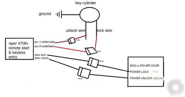

Posted By: carzynfr
Date Posted: June 25, 2014 at 1:53 AM
posted_image
let me know if i can wire the power locks, aux1 and aux2 with diodes the way i will not damage the remote start module

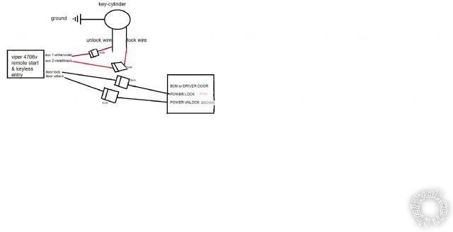

Posted By: carzynfr
Date Posted: June 25, 2014 at 1:54 AM
posted_image
Posted By: howie ll
Date Posted: June 25, 2014 at 1:58 AM
If you use that method don't program comfort close.
Posted By: carzynfr
Date Posted: June 25, 2014 at 2:07 AM
sounds good and what do you think about the diodes do i need them or i don't need them
Posted By: howie ll
Date Posted: June 25, 2014 at 2:08 AM
Play safe they cost next to nothing and it will protect the Viper circuitry.

Posted By: howie ll
Date Posted: June 25, 2014 at 10:44 AM
No idea, you're over thinking this, a common AMATEUR mistake.
First try a grounding the pink lock wire, see if that brings up the windows.
Also on lowering the windows you will UNLOCK the car.
