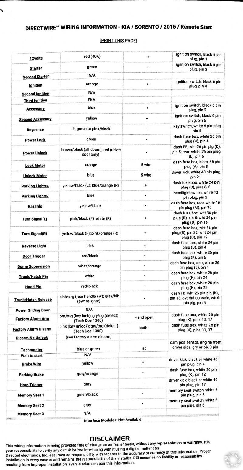

Here you go. https://readyremote.com/main.asp?action=select&yr=27510&product=Remote%20Start&make=Kia&model=Sorento

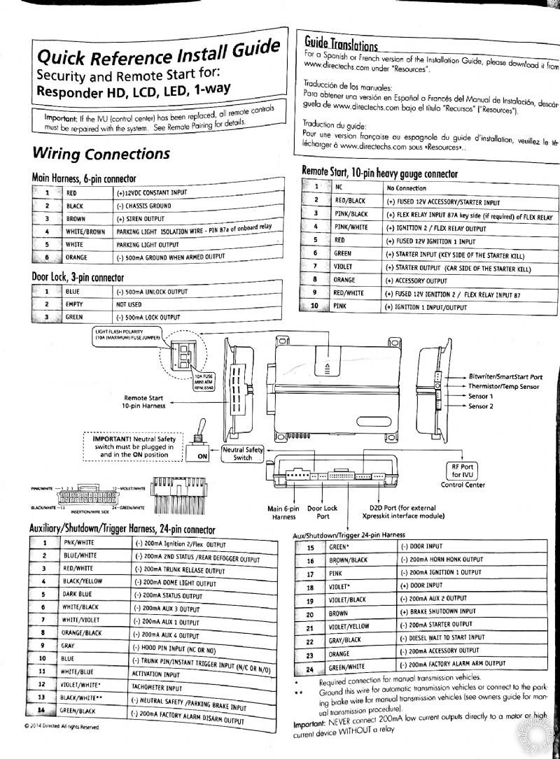

Can someone tell me what goes were? Thanks
posted_image
posted_image
Posted By: losboricua
Date Posted: February 02, 2016 at 7:19 PM
Not trying to sound like a dbag, but if you don't know the basic wiring mapping maybe you should have a pro do it. If you don't know exactly what you are doing you can mess it up really quick, specially with a Kia since they are known to have sensitive electronics.

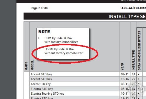

Okay so I went to a professional installation place it is a authorized Viper and directed dealer. He says that I need the dball2 to remote start. He said how are u going to remote start the car without the key in the ignition. U have to bypass it. I thought it was kind of strange when you told me it didn't need it.
Date Posted: February 03, 2016 at 10:15 AM
You need a bypass if your car checks for cars with key security. Kia and Hyundai are known for not having chip key base security unless you have a PTS. My wife 2012 Sorento and my friend 2014 Sorento without PTS work just fine with out a DBALL2. I have done about six other Kia/Hyundai without PTS and I did not need a DBALL2.

Posted By: chev104275
Date Posted: February 03, 2016 at 10:42 AM
Every 2015 Sorento key start I've done hasn't had a transponder key in it. No bypass required.
The above wiring from ready remote is correct for your truck.
Posted By: mscguy
Date Posted: February 03, 2016 at 10:43 AM
Maybe your install place is confused. In the Dball instructions, it doesn't even list a Standard key install option, only Smart Key. In the Idatalink install guide it specifies that USDM cars don't have a factory immobilizer.
