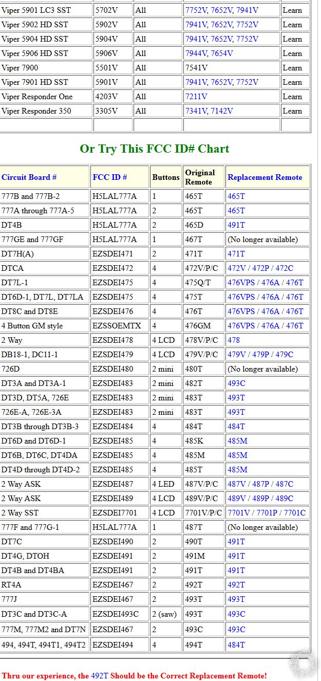

Posted By: lurch228
Date Posted: October 18, 2020 at 10:47 AM
Date code is 5 of 93 so should be a 493t remote (scratch code). Code should be on a white sticker inside of brain unit. posted_image

Posted By: lurch228
Date Posted: October 18, 2020 at 7:39 PM
posted_image
Posted By: lurch228
Date Posted: October 18, 2020 at 7:43 PM
posted_image
Posted By: lurch228
Date Posted: October 18, 2020 at 7:48 PM
posted_image
