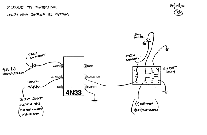

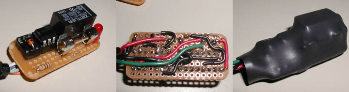

I built this circuit on a small piece of pc board and covered it in 1" shrink wrap. It is simply used to interface with the 5V reference voltage in my sunroof’s factory setup. For example, the reference lead to limit switch #3 reads +5V when the roof is fully closed and reads ground anywhere in the open position... therefore this circuit taps right into that lead. The relay activates when the roof is open and gives me an 'output' from pin13... in my setup this output is ground. I use this output to drive other relays to get what I want. Since I’m using an optoisolator the 2 circuits remain electrically isolated.
The circuit consists of the following components:
-Darlington optoisolator (4N33)
-9.1V Zener diode
-100 ohm resistor
-12V DPDT relay
-5mm LED (red)
-fuse (not shown)
The optoisolator is a simple integrated circuit that has an internal LED across pins 1 and 2. The low-current 5V reference from my vehicle is enough to light this LED. The other half of the 4N33 is a photosensor which detects when the internal LED is lit. Therefore the 4N33 is ideal for use in detecting when the 5V reference changes from +5V to ground or vice-versa.
In my setup, the double-pole double-throw (DPDT) relay activates when my sunroof is in the open position (i.e. when the limit switch #3 lead goes from +5V to ground). I put an external LED on the second pole of the relay so I would know when the relay activates. This is obviously optional. If you don’t need this then a SPDT relay could be used.
That’s all I have time for now. Have a great holiday!

Hey i like it, complete with fuse and all. Only thing i would say is to put a diode across the relay terminals to extend the life of the transistor.
What made you choose an optoisolator? I usually like using such devices but most people dont want to be bothered with any type of integrated curcuits.
I really like how well you placed it and wrapped it in shrink wrap.
Im not really sure why the zener diode is there? I must be missing something...?

Sorry about the delay... holiday weekend and all. I chose an optoisolator on my uncle's recommendation. It was the only thing he could think of that would be able to "read" such a low-current reference voltage of the limit switches. The Zener diode is used to drop the 12V input down a little so when the roof is closed (i.e. limit switch changes to +5V) the difference in potential would be small enough not to light the internal LED of the 4N33... which is what I wanted.
