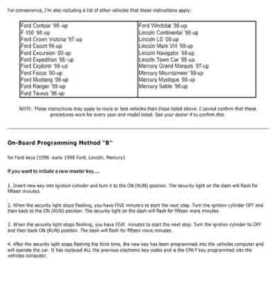

I don't think you need a master key with this car...check the attachment under programming instructions "B".
Sorry for the image, I had to keep it 30kb or less. Send me your e-mail and I can send you the original document if you can't read it from here.
Sorry for the image, I had to keep it 30kb or less. Send me your e-mail and I can send you the original document if you can't read it from here.posted_image

Mr. Fusion, I can't really read what your image says but it probably has something about how to program additional keys using only one key. Problem is, the original poster has NO working keys left.

Not according to this...this procedure is for programming a NEW master key WITHOUT any existing keys. This is supposed to work on the earlier Ford PATS systems like the '97 Taurus. I can send anyone the original JPG if they would like to see it.

Mr. Fusion, I saved that jpg to my computer and opened it from there. I was able to barely read it at that point. Can you send me a copy in case I ever run into that problem on a customer's car?
