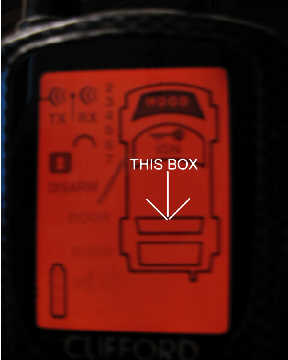

if you notice when you put in the battery on your remote, you will see numbers 1 through 6 scroll down the side of the car. if when you open the hood it should report zone 6, but shows the trunk. all you have to do is hold down all of the buttons to change the settings on the remote. the trunk should report zone 1 and the hood should report zone 6. if you open the hood and it reports zone 1, he installed it wrong.

jc18750, I just triggered the alarm on my car with the hood and trunk but both don't report any zones being breached.  The trunk icon just lights up.  And the numbers go from 2-7 so I dunno.....  Do you think maybe that's just for Clifford's Matrix?

sroth140 is right. the blue wire on the main harness is labeled "multiplexed trigger input" in the install guide. it says that it is commony used for the trunk. the grey wire on one of the smaller harnesses is strictly labeled "hood pinswitch shutdown wire.". i checked my new remote, and your right. it goes from 2 - 7. zone 1 is for the shock sensor and it is seperated into this box. 1 & 2. 1 is for the blue wire on the shock sensor. and green is for an extra sensor (sold seperately, such as a motion sensor). posted_imageanyway, if you hold down the unlock button, lock button, trunk button, and the aux button on the remote all at the same time, your remote goes into programming. press the TRUNK button to select between trunk, hood, neither, or trunk and hood. don't press anything for about 5 sec and remote will exit programming. follow this link, and i have a short movie of how to do it. it's about 26 seconds long. you don't have to press all of these buttons, but i did them all.remote link
