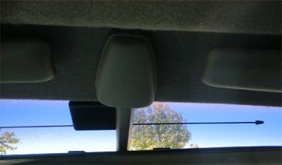

I was very wized because they didn't ask me where to mount the responder antenna, they mounted it near the rearview mirror, and it wasn't aligned to the center at all. I actually wanted them to mount such a thing to the rear window.
They also screwed up the power trunk, my trunk can no longer close properly (can't use too much force to close it, can't slam it or so).

--It is standard procedure for the antenna to be mounted on the windshield, and the cable is probably not long enough to reach the back window, unless maybe it is a little car.
On some cars, the rearview mirror doesn't allow the antenna to be in the exact center. Also, if your windshield has those little black dots to keep out the sun, they are metaallic and can affect range......so the antenna should be mounted away from those.
In any event, though, if the antenna is crooked or otherwise sloppy looking, that is a shame, and it bugs me too.
Have them fix it.
Is there a chart you can look it up for 95 240sx? Or is the antenna cable extendable?
But that wasn't the case for my car, there are plenty of space, but somehow they just didn't mount it center. Around 3 inches to the left is way too obvious and it looked too sloppy. They said once its mounted, can't remove it without risking to break it.
Mounted in the back window instead of the front?
Thats a ly about breakig it. Its just double sided tape. use a knife and while pulling the antenna cut the tape. Then clean off the rest of the tape and use some quality 3m tape to remount antenna.

There is no chart for antenna length but if I had to guess, and they installed the brain properly its very unlikely it would reach. Properly installed in the center on the front is probally the best you can hope for. The Aux outputs are generally for things like window roll up and down and things of that nature. All these are definatly extra features you pay for. Since its a combo unit there would have been a hood pin in the box and should have been installed as part of the standard install IMO. Starter kill is a per shop basis. Some place install it for free with the unit others charge. Same with trunk pin, some include it some dont. You cant assume they would know you want it done just becuase you are getting trunk release done, but it should have been presented to you.

Yes, I'd like to relocate the antenna to the top or bottom in the center position of the rear window. I don't care if i lose up to 20% of reception, but placing the antenna in the front really gets in the way. Even placing sun shade on the windshield I had to be really careful not to break the antenna.

Anyhow, I went to the shop (very calmly) and asked the boss for my H2 harness, got it and left the shop within a minute or two.
I also took a pic (as shown below) of the antenna mounting positon so the ones who thought I was lying can have a look and make your own call. Remember, you might not think it's a big deal, but don't do this to your customers or they would be very unhappy like me.posted_image

Date Posted: August 07, 2006 at 1:25 AM
what the hell is wrong with that. Its a little to the left but maybe the wire couldn't be reached. I think showing that picture will bring a new doodieload of bash to you. Why are you complaining about that. Because its a little to the left, no biggie, works the same.
Posted By: bsd1
Date Posted: August 07, 2006 at 1:34 AM
That is exactly what I was told by the installer. Three inch to the left is too obvious.
I thought so earlier as well. But then I found out a great length of antenna was taped up near the brain. Want me to take a pic of that to proof you? I guess not. Like I said, most installers have good workmanship. I by no mean to offend some of you lazy installers. Just to let you know that it's a very big deal.
Posted By: spookiestylez
Date Posted: August 07, 2006 at 2:36 AM
The antenna should have been placed at the center of the windshield, nuff said. Just because its noticable and first time owners always bitch about everything and act like they know whats wrong.If you were to buy a alarm/etc from my shop and install, we have a lifetime warranty, but if someone goes behind me and starts unplugging sh** and doing this and that,guess what , your on your own,regardless if your having problems or not.If you were having problems w/ it, call or come back to the shop, let them deal w/ it, because thats their responsibility.Sorry that you got F*ed on your deal,you gotta watch out for those corner shops, great for some things, not others! I'd like to see pics of the install though.

Posted By: Chris Luongo
Date Posted: August 07, 2006 at 8:01 AM
Fastlearner,
If we install something like a sunroof or a leather interior, there are MANY opportunities to do either beautiful or poor work..........when a customer picks up a car from a leather install, and sees all of the seams neat and straight, no wrinkes or lumps......it makes them very happy, and they'll want to do business with us again.
Same thing for installing amps and/or subwoofers; there's a lot of stuff for the customer to look at and appreciate.
But when we install an alarm or remote starter, nearly everything is out of sight........the car doesn't look or behave any differently from before.......unlike a leather interior, it appears to the customer that they've just spent HUNDREDS of dollars for a couple of little remotes.
So, as alarm installers, we have very little opportunity to show off our skills to the customer.
The only opportunities we really have are the antenna, LED, valet switch, owner's manual, and remotes.......that's all the customer gets to see.
If the LED is mounted neatly and without scratches, the owner's manual on the dash, valet switch in a good spot where they're not going to bang it with their foot, the clock on the LCD remote set to the proper time and attached to customer's keychain.......and the antenna mounted nicely.............the customer will be impressed.
If they see the LED off-center, the antenna crooked, owner's manual on the garage floor with a footprint on it, and the remote tossed on the cash-register counter, the customer will think (and rightly so) that we are incompetent slobs.
I'm a neat-freak and detail oriented........not all installers are and that's understandable........but it is best if we assume customers are that way.
Likewise, a clever electrician will install all of his switchplate and outlet covers with all of the screws lined up either vertically or horizonatally........customers notice and love that stuff.
