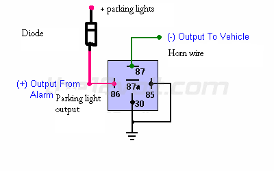

You can also use the parking light output from the alarm using a relay to convert the output from positive to negative. One thing you need to do is put a diode in-line, cathode (stripe side) facing the vehicles parking lights.
posted_image
Sorry,in advance, for modifying a pic from the website.
