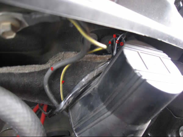

Hate to be annoying, but I'm still a bit confused. Here is an actual picture of what I see. Which wire do I cut?
posted_image
Thanks.
Posted By: swamprat323
Date Posted: May 21, 2007 at 10:58 PM
untape ALL the wires so u can see them all. waht u will have is
red
black
black wire that is LOOP back in siren
black with a white stripe thsi also is LOOP back int siren
cut the black wire that is LOOP back in siren.
Posted By: eyesonly
Date Posted: July 07, 2007 at 9:51 PM
Finally got a chance to try this. Worked perfectly. Thanks!
